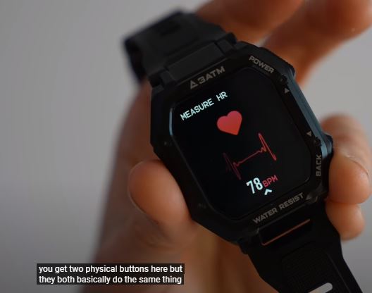

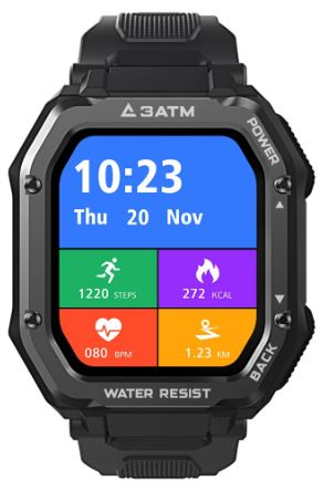

Techos78 Posté(e) le 17 juin 2021 Auteur Partager Posté(e) le 17 juin 2021 (modifié) Well, just for fun, have you seen the Kospet Rock, huge battery, metal case, screen not really rectangular but 2 buttons... https://www.kospet.com/products/kospet-rock-smartwatch Well done for your ks-s18, it's interesting, and if you want you can create a topic in the Kingsong subdirectory, I'm sure some users will want to learn that. Only condition: it will be necessary to translate into French to comply with forum rules. I say that, but I'm not an administrator, so you do as you want . Modifié le 17 juin 2021 par Techos78 1 Citer Lien vers le commentaire https://www.espritroue.fr/topic/16585-euc-watch-hackable/page/11/#findComment-303512 Partager sur d’autres sites More sharing options...

enaon Posté(e) le 17 juin 2021 Partager Posté(e) le 17 juin 2021 (modifié) 4 hours ago, Techos78 said: Well, just for fun, have you seen the Kospet Rock, huge battery, metal case, screen not really rectangular but 2 buttons ... https://www.kospet.com/products/kospet-rock-smartwatch this is the same as the magic 3, same board, and I think I recall atc1441 saying it was a one button watch, no matter the markings on the case. Modifié le 17 juin 2021 par enaon Citer Lien vers le commentaire https://www.espritroue.fr/topic/16585-euc-watch-hackable/page/11/#findComment-303529 Partager sur d’autres sites More sharing options...
Techos78 Posté(e) le 17 juin 2021 Auteur Partager Posté(e) le 17 juin 2021 il y a 16 minutes, enaon a dit : it was a one button watch Strange... Citer Lien vers le commentaire https://www.espritroue.fr/topic/16585-euc-watch-hackable/page/11/#findComment-303532 Partager sur d’autres sites More sharing options...
enaon Posté(e) le 17 juin 2021 Partager Posté(e) le 17 juin 2021 6 minutes ago, Techos78 said: Strange ... we will see, maybe it is an analog sensor, but as it stands it is a single button board. 1 Citer Lien vers le commentaire https://www.espritroue.fr/topic/16585-euc-watch-hackable/page/11/#findComment-303533 Partager sur d’autres sites More sharing options...
Techos78 Posté(e) le 17 juin 2021 Auteur Partager Posté(e) le 17 juin 2021 (modifié) you are the specialist, I'm just an earthworm . It would be great if Kospet used an oled screen... Edit : the confirmation: Edit2 : there are different screen sizes and resolutions: P8 = 240x240 , Kospet Rock = 240x280 , Kospet Magic 3 = 280x320... Is EUC Watch drawn with areas, border cliping, graphics, character size... defined in percent of viewport, not in pixels, to ensure correct scaling?. Modifié le 17 juin 2021 par Techos78 1 Citer Lien vers le commentaire https://www.espritroue.fr/topic/16585-euc-watch-hackable/page/11/#findComment-303535 Partager sur d’autres sites More sharing options...
