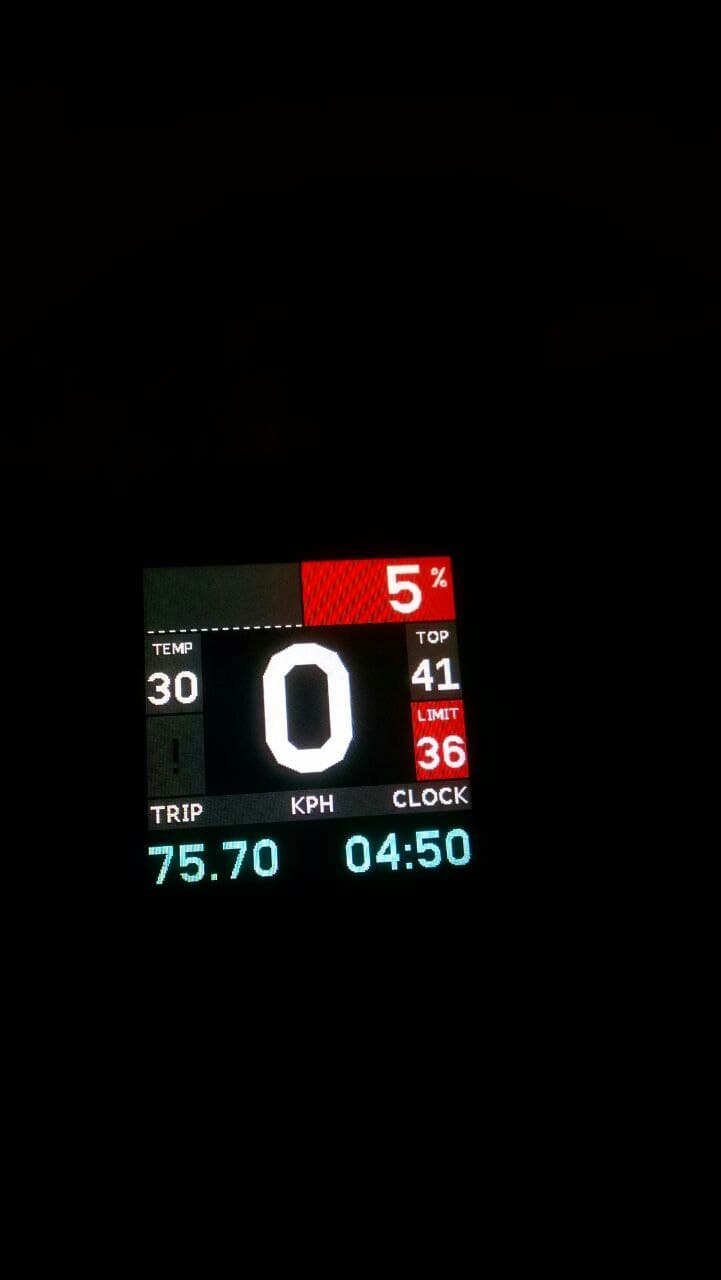

bugatti45 Posté(e) le 23 juin 2021 Partager Posté(e) le 23 juin 2021 (modifié) Citation Set again the limits of 40/45 to more appropriate numbers using the watch, and please tell me if the buzzing stopped. Hi @enaon I set appropriate numbers on my watch and the buzzing doesnt stopped, but .... when I riding, background of the mark (!) is RED Modifié le 23 juin 2021 par bugatti45 Citer Lien vers le commentaire https://www.espritroue.fr/topic/16585-euc-watch-hackable/page/12/#findComment-304071 Partager sur d’autres sites More sharing options...

enaon Posté(e) le 26 juin 2021 Partager Posté(e) le 26 juin 2021 (modifié) On 6/23/2021 at 4:11 PM, bugatti45 said: Hi @enaonI set appropriate numbers on my watch and the buzzing doesnt stopped, but .... when I riding, background of the mark (!) Is RED Hello, this dash looks like a mistake, the "B 'symbol is not displayed in kingsong wheels, a number with the real variable speed limit is shown instead, like so: Please try the following: 1.Go to the garage page, long hold on the wheel, and then long hold on delete, to delete the entry. 2. Do an up-gesture to go to settings, then info icon, then press on the restart button to restart the watch. 3. Add the wheel again. (by long hold the side button, or long hold on an empty garage slot) If this does not help (the 'B "symbol still shows up), then please do a install again from the loader. Modifié le 26 juin 2021 par enaon Citer Lien vers le commentaire https://www.espritroue.fr/topic/16585-euc-watch-hackable/page/12/#findComment-304375 Partager sur d’autres sites More sharing options...
bugatti45 Posté(e) le 8 juillet 2021 Partager Posté(e) le 8 juillet 2021 Hi @enaon, the "B symbol" is now replaced by a number (speed limit) 😀 but I have always an exclamation mark above "TRIP" and my watch buzz all the time 😢 Citer Lien vers le commentaire https://www.espritroue.fr/topic/16585-euc-watch-hackable/page/12/#findComment-305386 Partager sur d’autres sites More sharing options...
