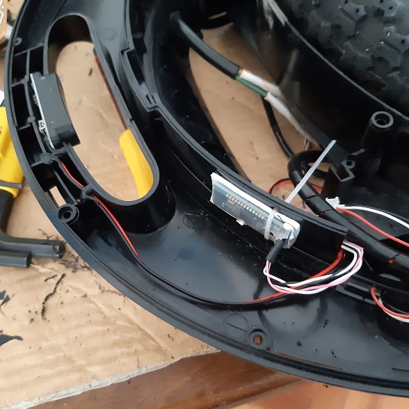

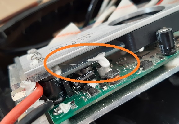

Cormo Posté(e) le 24 octobre 2021 Partager Posté(e) le 24 octobre 2021 On the Tesla V2 the bluetooth module is plugged on the main board, sandwiched between two aluminium brackets. No wonder the connexion is bad. Due to a puncture I had to dismantle the wheel, so I took profit of this to move the bluetooth on top of the casing. @enaon I will tell you later if the watch works better with this configuration. As I have several other improvements to apply to the Tesla, I cannot test it for the moment. 1 Citer Lien vers le commentaire Partager sur d’autres sites More sharing options...
enaon Posté(e) le 25 octobre 2021 Partager Posté(e) le 25 octobre 2021 10 hours ago, Cormo said: @enaon I will tell you later if the watch works better with this configuration. As I have several other improvements to apply to the Tesla, I cannot test it for the moment. excellent, thank you very much Citer Lien vers le commentaire Partager sur d’autres sites More sharing options...
