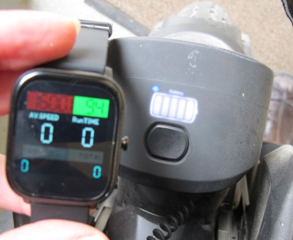

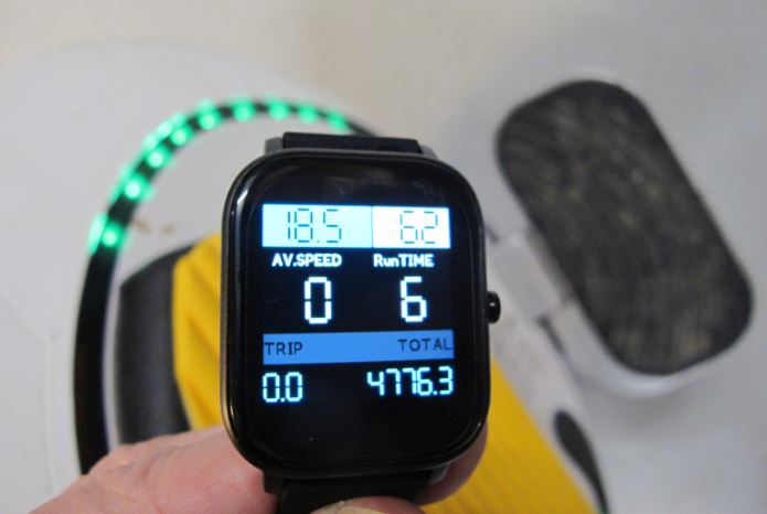

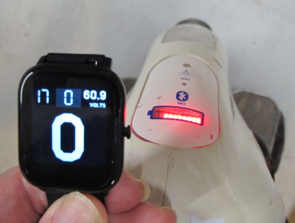

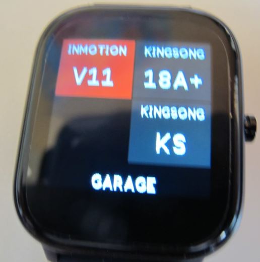

Techos78 Posté(e) le 1 mai 2021 Auteur Partager Posté(e) le 1 mai 2021 I connected the watch to my three wheels: It works V11 : KS18A : ( with the right level of autonomy ) KS16B : funny note: the speed of the v11 is negative when rolling backwards, the KS are always positive, this is normal as they are not "polarized" wheels. 1 Citer Lien vers le commentaire https://www.espritroue.fr/topic/16585-euc-watch-hackable/page/6/#findComment-297628 Partager sur d’autres sites More sharing options...

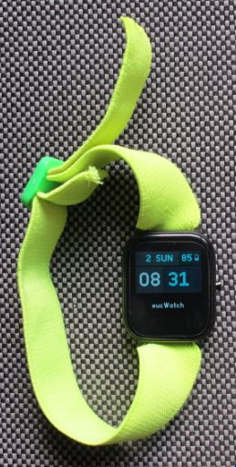

Techos78 Posté(e) le 2 mai 2021 Auteur Partager Posté(e) le 2 mai 2021 Suggestion : pour porter la montre par dessus un vêtement, on peut utiliser une bande élastique : 2 Citer Lien vers le commentaire https://www.espritroue.fr/topic/16585-euc-watch-hackable/page/6/#findComment-297711 Partager sur d’autres sites More sharing options...
spiken Posté(e) le 2 mai 2021 Partager Posté(e) le 2 mai 2021 @Techos78 c’est exactement ce que je cherchais ! Mais hélas sans rien trouver. Citer Lien vers le commentaire https://www.espritroue.fr/topic/16585-euc-watch-hackable/page/6/#findComment-297753 Partager sur d’autres sites More sharing options...

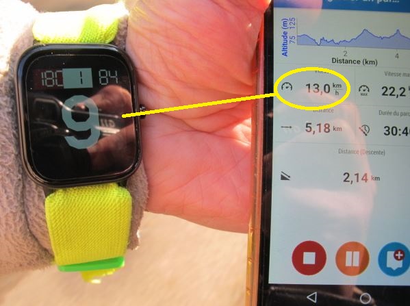

Techos78 Posté(e) le 4 mai 2021 Auteur Partager Posté(e) le 4 mai 2021 Thanks @enaon . From now, on my wheel, I always wear the watch on my arm , it's very very very pleasant, I can't do without it anymore. The start-up is very simple: double press button, press "run time" window ... and it works. To change the menu, the finger swiping does not always work very well, just have to retry. I don't know if there is a method to end the session, I wait for the bluetooth loss time-out, and I press the "run time" windows to stop the vibrations of the watch. I saw in your video that the color changes of the speed display no longer exist. I think it's clearer, especially in direct sunlight. And there are many new functions to discover ... And also the displaying of some units, which removes the doubt (km / h ...). Excellent, really. I will try all of this asap. Citer Lien vers le commentaire https://www.espritroue.fr/topic/16585-euc-watch-hackable/page/6/#findComment-298015 Partager sur d’autres sites More sharing options...

Techos78 Posté(e) le 4 mai 2021 Auteur Partager Posté(e) le 4 mai 2021 (modifié) Le 04/05/2021 à 14:06, enaon a dit : It is even simpler. Just long hold the button, it will connect/diconnect, no matter the screen it is on etc. Développer I tested several times, I can only say one thing: it's absolutely perfect. In addition, as the garage is emptied by firmware upgrading , long button press immediately opens the garage and allows the wheel to be declared, which is quickly identified. Wow, good job! I will look in detail a little later, for now I see that the battery voltage is correct, the temperature too, the "trip" data has a wrong scale factors : it progresses about 10 times too fast but it reacts correctly to KPH-MPH swapping, . "TOTAL" is 0, the speed bargraph run well (full scale near 40), it is colorized yellow above 22, red above 30, too much to watch, amazing. The screen lighting is pretty well managed, it turns off when the arm is down, and it turns on when moving. I will measure the autonomy of the watch, my goal would be to ride for 3 hours, I don't resist any more without stopping. ... we may have to think about taking the usb charger base ... I just saw that recharging the watch does not reset the TRIP distance to zero. Good. -------------------------------------------------------------------------------------------------- Aux membres du forum qui suivent ce topic, je dis clairement : dans l'état actuel, ce système est très proche d'une version finale, avec quelques ajustement mineurs suivant les roues... La difficulté est d'acheter la bonne montre, une P8 écran 240x240 avec le bon chipset, mais le risque est minime : 20€. ...GO... Pour ceux qui peuvent attendre, il semble qu'enaon s'apprête à porter son application dans une montre un peu plus élaborée, avec une autonomie légèrement supérieure et un bouton double effet. L'idéal serait un écran OLED, mais je pense que cela n'existe pas dans cette catégorie. Modifié le 4 mai 2021 par Techos78 1 1 Citer Lien vers le commentaire https://www.espritroue.fr/topic/16585-euc-watch-hackable/page/6/#findComment-298034 Partager sur d’autres sites More sharing options...

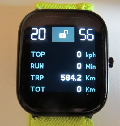

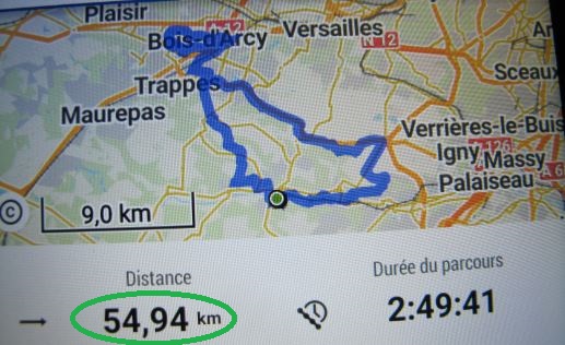

Techos78 Posté(e) le 5 mai 2021 Auteur Partager Posté(e) le 5 mai 2021 Test d'autonomie de la montre P8 : J'ai fait un parcours de 2 heures 50 minutes avec une luminosité 3 sur 7, et l'écran allumé environ 95% du temps : la batterie restante est 47%, par conséquent l'autonomie globale est supérieure à 5 heures, c'est parfait. Avec un temps couvert ou un soleil pâle, la vitesse reste lisible. Test eucWatch sur une Inmotion v11: Je préfère le menu le plus complet, les chiffres de vitesse sont suffisamment gros, Dans le menu simplifié, les très gros chiffres ont quelquefois des erreurs de cadrage horizontal : trop à gauche ou trop à droite tronqué. La mesure de vitesse est très voisine de la vitesse gps. Bien. La mesure de distance TRIP est fausse, environ dans un rapport 10 : La tension finale de la roue était 73.4 V , le pourcentage 56% ce qui me semble optimiste, Petite vitesse moyenne 20 km/h, mais parcours avec beaucoup d'arrêts-démarrages, et beaucoup de vent aujourd'hui. (et ~25 lapins près du lac). Pour l'instant, mon enthousiasme n'a pas baissé. A suivre... 1 Citer Lien vers le commentaire https://www.espritroue.fr/topic/16585-euc-watch-hackable/page/6/#findComment-298164 Partager sur d’autres sites More sharing options...
enaon Posté(e) le 5 mai 2021 Partager Posté(e) le 5 mai 2021 (modifié) Le 05/05/2021 à 16:26, Techos78 a dit : J'ai fait un parcours de 2 heures 50 minutes avec une luminosité 3 sur 7, et l'écran allumé environ 95% du temps : la batterie restante est 47%, par conséquent l'autonomie globale est supérieure à 5 heures, c'est parfait. Avec un temps couvert ou un soleil pâle, la vitesse reste lisible. Développer Thanks for testing. Screen-on most of the time, means you have the speed haptic alert very low. The number you set on the speed haptic menu, is not just for the buzzer, it also changes the color of the display, and turns on the screen. It is something like an alarm, ready to see, but maybe if you want better battery life, take it a bit higher. You can enable/disable the buzzer output, but the color change and the screen-on is not selectable yet, it will happen over the limmit. The watch should be able to do over 2 days of riding with sceeen off, and about 3 hours with screen on at 7, so if you set it to always-on at a higher speed, it will last all day. The menus will change to make this simpler, I only write all this for your tests, thanks for doing them this is the part that takes the screen on, if either speed or amprere is over the set values on haptic menu for inmotion, he screen is on too. Quote //screen on if ((1<euc.dash.spdC||1<euc.dash.ampC)&&!w.gfx.isOn ){ face.go(set.dash[set.def.dash],0); } Développer ps. I am following all the issues you report, I will add them and let you know if you can test. ps2. there is a global gesture you may find useful. A swipe up from bottom left corner, will toggle setbrightness/fullbrigtness, just a quick way to get it to full from any screen, without changing your settings. ps3. Le 04/05/2021 à 12:28, Techos78 a dit : the finger swiping does not always work very well, just have to retry. Développer This maybe means that you have the 716 controller, there is a version that works even if 816 is selected, but not well. You can update only the handler file from the loader page, and select the 716 to see if it gets any better. https://enaon.github.io/eucWatch/p8#core Modifié le 6 mai 2021 par enaon Citer Lien vers le commentaire https://www.espritroue.fr/topic/16585-euc-watch-hackable/page/6/#findComment-298194 Partager sur d’autres sites More sharing options...
