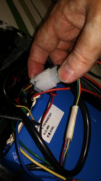

Metalazo Posté(e) le 4 avril 2018 Partager Posté(e) le 4 avril 2018 (modifié) Il y a 5 heures, Norgs a dit : Hello all. I have a friend wth a H8, and I am trying to help him troubleshoot a problem. He was riding his H8 and briefly noticed an error message appear on the screen. Shortly after the error appeared, the scooter powered off while moving. It would no longer power on after this event. I helped him open the deck and look to see if there was any visible sign of damage or fault. Nothing was found and we re-assembled the scooter. After charging the battery the scooter was able to be re-armed and turned on. There is an error message on the screen and use of the accelerator does nothing (the scooter will not run the motor). Does anyone have tips on what 'Error 2' may be, and what should be the next step for troubleshooting? I am in contact with Kylin, but I think he must consult the factory for each step, and I hoped someone in this forum could assist in my troubleshooting. The scooter is less than 6 months old. It has done less than 275 km. Please accept my apologies, I can only speak english - I'm from Australia. Dear Norgs, I had similar issue last year. My counter is different and default alert is not shown with a number. But seems the controller is faulty, The only way to try to reset it, is to cut battery signal to the controler. You can wait till the battery is fully discharged (that can take months) or to open the deck en disconnect the battery via XT60 connector (see below picture the yellow connector). Be carrefull when doing this operation. Then reconnect the plug, you should ear sound notifiying reset is done. Second step for me was to find the root cause of the issue. I put the scooter on a stand in order to be able to accelerate without touching the ground. In the same time i tried to moved the cable into the deck in order to find if something happened. And finally i was right, cause the rear wheel started to make big noise and the scotter shutdown as initial issue. I finaly found the cause, that was a crappy connector making signal cut. (See picture with white connector) Hope it will help, as it was for me. Best regards. Citation Modifié le 4 avril 2018 par Metalazo Citer Lien vers le commentaire Partager sur d’autres sites More sharing options...

ipso21 Posté(e) le 5 avril 2018 Partager Posté(e) le 5 avril 2018 (modifié) En rentrant du boulot cet après-midi (trajet quotidien 2 fois 13 km) et alors que le compteur affichait 3 barres sur 6 comme d'habitude, la trottinette a brusquement ralenti avant de s'éteindre complètement comme lorsque vous arrivez en fin de batterie. J'ai vainement tenté de la rallumer à plusieurs reprises, de désactiver le verrouillage avec le bip... rien du tout. J'ai dû me taper une bonne dizaine de km à pieds.... En rentrant, je l'ai branchée cinq secondes sur le chargeur avant de l'enlever et l'ai rallumée avec le bip (car elle s'était mise en mode sécurité visiblement...) : elle affichait à nouveau trois barres et j'ai pu faire tourner la roue arrière à vide sans problème. Quelqu'un a une idée de l'origine de ce problème ? C'est la première fois que cela m'arrive et ça fait vraiment flipper de se dire qu'elle peut nous lâcher sans prévenir loin de la maison.... PS : pour info, je n'ai pas touché aux valeurs de réglage qui sont les mêmes depuis mes modifs d'octobre dernier. Modifié le 5 avril 2018 par ipso21 Citer Lien vers le commentaire Partager sur d’autres sites More sharing options...

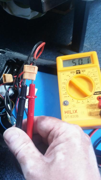

Funny Posté(e) le 7 avril 2018 Partager Posté(e) le 7 avril 2018 La galère Je commencerai pas faire un visuel de toute la câblerie, même si cela ne semble pas provenir d'un problème de connectique. Ensuite je solliciterai Kylin pour avoir son avis. As tu un moyen de vérifier les tensions de sortie après une charge ? 1 Citer Lien vers le commentaire Partager sur d’autres sites More sharing options...
ipso21 Posté(e) le 7 avril 2018 Partager Posté(e) le 7 avril 2018 (modifié) Hello @Funny, J'ai un multimetre et un charge doctor de @hobby16 que je n'ai utilisé qu'une ou deux fois car incompatible au niveau des ports d'entrée et de sortie (j'aurais dû le préciser au moment de l'achat...). L'adaptateur que j'avais fabriquée est HS et je dois avouer que j'ai peur de faire une bêtise en en fabriquant un autre... Est-il possible de mesurer la tension avec un multimetre sans accéder directement aux bornes de la batterie? Sinon, j'ai envie de croire que ce n'était qu'un bug du contrôleur, du coup je vais tenter un nouvel essai cet après-midi mais il est clair que si cela se reproduit il faudra ouvrir la bête pour voir ce qu'il y a... Modifié le 7 avril 2018 par ipso21 Citer Lien vers le commentaire Partager sur d’autres sites More sharing options...
Techos78 Posté(e) le 7 avril 2018 Partager Posté(e) le 7 avril 2018 il y a 23 minutes, ipso21 a dit : Est-il possible de mesurer la tension avec un multimetre sans accéder directement aux bornes de la batterie? Pour info, sur une roue, c'est oui ou c'est non, selon la présence d'une diode anti-retour qui protège le port de charge. Donc, quand on mesure sur le port de charge (attention à ne pas faire de court-circuit avec les pointes de touche) : -- roue Gotway par exemple, oui, on mesure la tension de la batterie. -- roue Kingsong par exemple, non, on mesure une tension très mal définie (inexploitable), souvent autour de 20 Volts, dépendante de l'impédance du voltmètre. 1 Citer Lien vers le commentaire Partager sur d’autres sites More sharing options...
Raven450 Posté(e) le 9 avril 2018 Partager Posté(e) le 9 avril 2018 (modifié) Sur la H8 on peut mesurer la tension avec le charge doctor effectivement, ça marche bien. Bon sinon j'ai crevé avec ma roue arrière ce weekend, il s'agit d'un petit trou (une sorte de grosse agrafe). Quand j'ai enlevé l'agrafe du pneu (qui était à plat), et que j'ai regonflé le pneu, le liquide anti crevaison a commencé à sortir. J'ai donc mis la tortt à la verticale avec le trou en bas pour que le liquide aille bien dedans. Après plusieurs heures passées, un peu de liquide s'est écoulé et a séché et ça ne semble plus fuir. J'ai fais un petit tour rapide, ça a l'air de tenir pour l'instant mais j'ai peur que ça lâche à tout moment ! Je sens que je suis bon pour tout démonter et mettre une rustine ! Le truc c'est que j'ai plus confiance pour aller au boulot Du coup je me tâte à me racheter une Xiaomi M365 à 325€ livraison incluse, d'autant plus qu'on peut maintenant la débrider pour qu'elle monte à 32km/h avec une puissance moteur de 850W.... Elle me servira pour mes petits trajets ou comme trott de secours dans ce genre des cas Modifié le 9 avril 2018 par Raven450 Citer Lien vers le commentaire Partager sur d’autres sites More sharing options...
