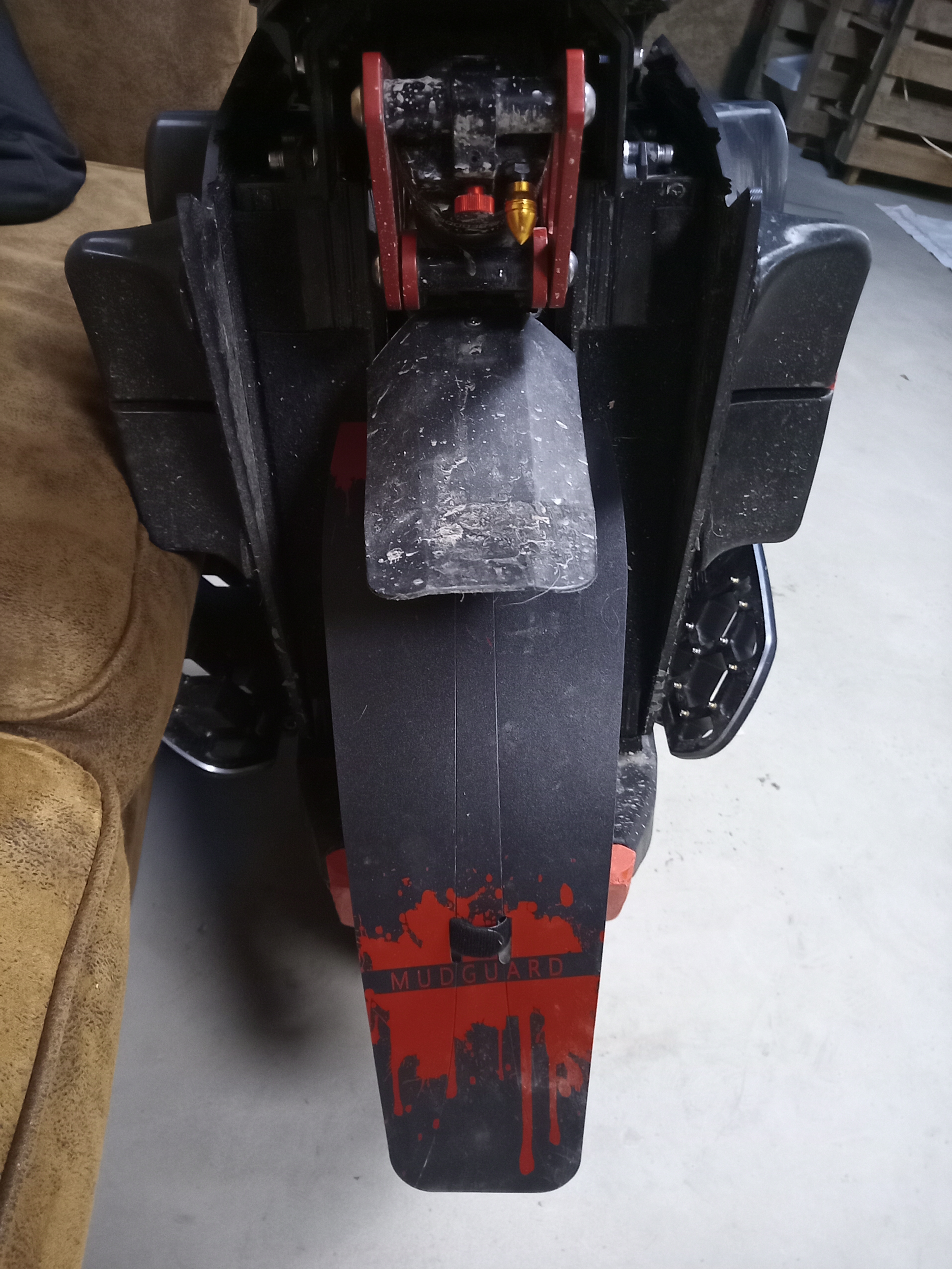

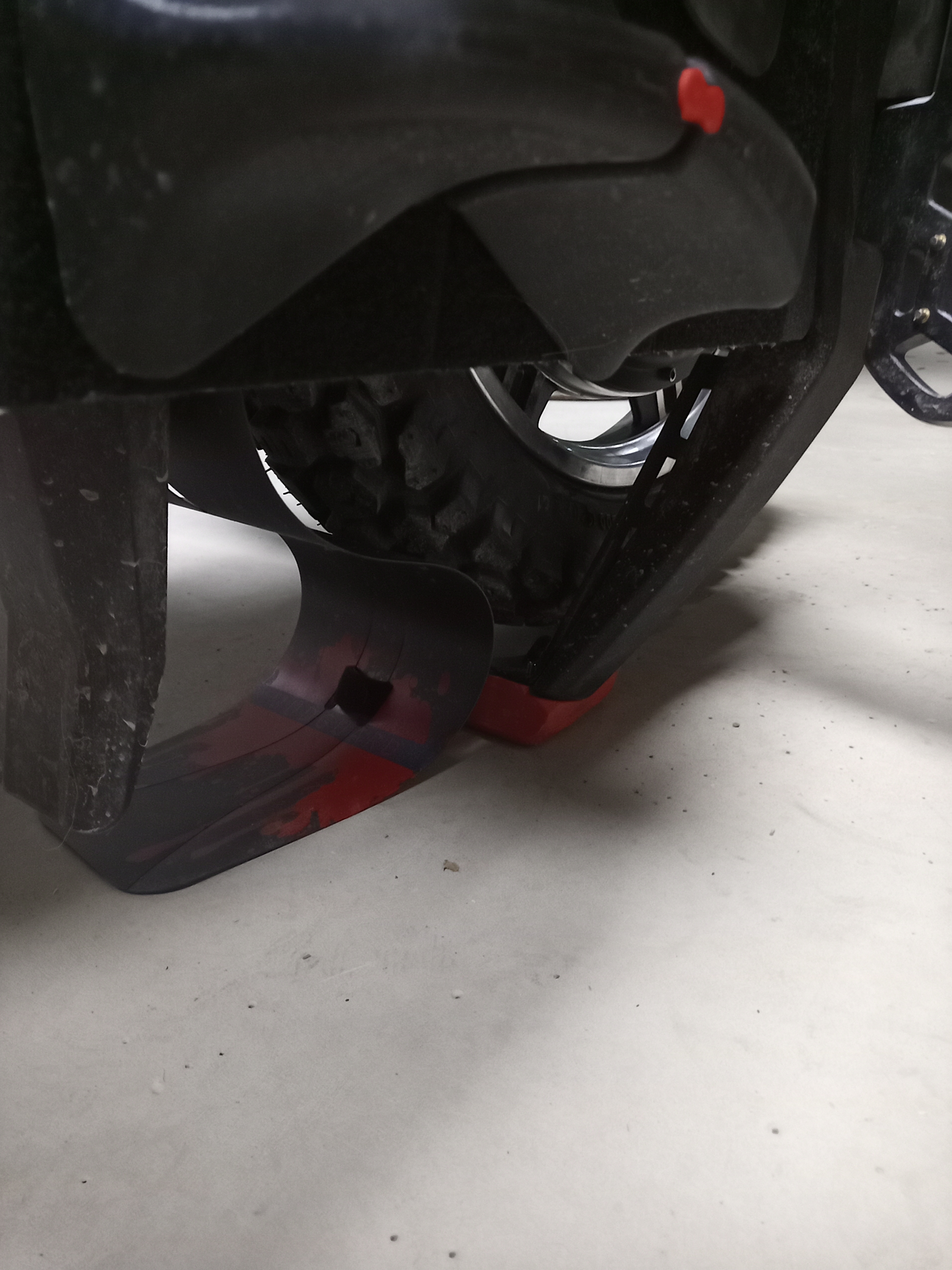

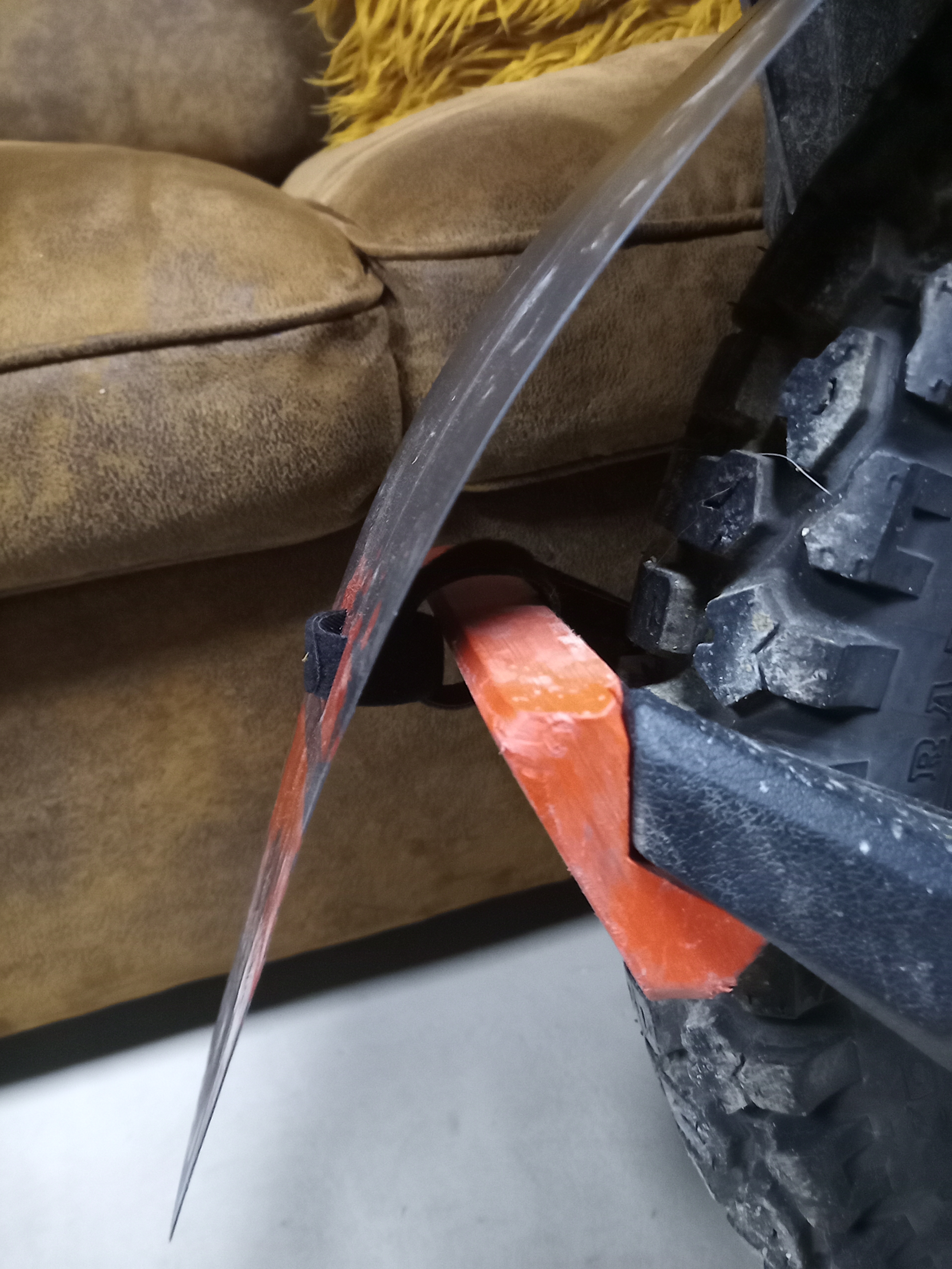

Il y a 1 heure, malaman a dit :
Super ! Tu aurais la référence de ton gardes boue stp ?
Garde boue avant universel chez Decath'
Le mieux est d'aller voir car il y a plusieurs modèles/design
Je l'ai fixé comme ça, mais attention, c'est près du pneu et j'ai réhaussé la suspension du coup (Begode fourni des cales avec le pneu offroad):
QlB9ZdiX9RpRC4IbNaVueTeW2fLzRoXUSubDpTmBID7_V1cecj0AqtzqHnrIHtR4M8gbn2kSaRmuAjXm_wZuBNHTQqwcRnmGVD5v0ot_uUDvcRDm6mUVsYr7JCW9rg7UcqZigO46DuWIi0cksGhC408BWOE6PaDRtqx2pzlN0Ny2zbgYsgDdcJ3peSpxcH_QNciplks9qFfpw2J2ctw94JlOpUwNOmFgQVUAVn-n64Ej9iwhniv6KfUyR7u1EodPoOrHoQcCEYV9M-K7W_BtdXtR4CbatY86-VSmM8cL5USEzqypVGLMBDpEOSsJ545Se-Vf7yH--acueIgkiIly-UWqmzoBKtXTok0SUkWVxmxXdRHXZHZrCHLyJ_zmERHsmUWfEjoIBdZeEgMVKtBUy5hef150ACHMXM5Tlcgh5D-z5gKxh8fRn5hKjo76Z51y-2yCvl6DIbwHo2j8ZOfDJm5wo_qnZPwEa22I7AA20vD-NDkih053uDX1RoO2gI9zjjdn8qASxy91DUC6BvrAtcwySEjiPA-0flano8rAlvCgG9geeip6rrDkkvFYxibLtu6t1OvZQNsyZuCTfGMSOmmIx36lIXGHseb6OZBQWjmr8s9N_Xu__5_iZgrKke7HjEI7p90J829FEc6vHCsRaTAFMDXJk7qfib-uvJLA4rsPUWDpVGu8RRfi-vftlJdPKtiSyV3feZswZuOQne3Bi5-LvtHamAoARVe9KGg6jjxn7YSJawWLEaXO1svTJvQ96fzsN0efsGKQJX9TPzoxbSD5Q582XSvmeQ5iNs2ndIYc-vblpI02AeF6cg2U_y3lq6_EbPgO1bF4pSITIUCrw5YrZSbTHypHPk8mcuH-m4FMtGQ_Ic2RBtkcL4QR6r0mMy00Gotk8Oo0C81_Bmm5d2DCSt_o_n8kDbme5E7BOFd88Q=w1666-h937-no?authuser=0
40RCM2CWYU5Wmv2s3aGK7sN7eR3xSUYyYwvdNAYrTCHF_r9D6rCxZA5YEFqPHHMuN80vvrTWsFIQWXeP4vmMqqrskC73UVlMf9WDlNrN6MIgLtYw9cbNAGq7WPJ7kSaPb1Hw8zZZXrVu19VD_8oaWf7Le4Z9TsJ89YdCLroI3eFfcgh4K_b1LWNzMWeaS2qOenB4EQptUjy9_6Zfcn2A8Hdab_bQ9u3EDtanp-7ywPCRM7uYHiX4xkMSXnvnbPZX5l7h7m3QdD1dTRD43Ed3gXKrhKkJ0BVdtaSon5pxRn4Ik6HiQ65dzuhmOF-wBg834UINMLAqYfm2KNWnhpm0mkfv6q8YCgb5IDn_KG5fiR1LheoV2oB8iBSPXuOUsjEGYWLwdczttJEQe1t8Zs3FKP4N2PYnt-397NJrVMx42KOkpng34sYEv5uJqbulS0pEi2tTip9RzklGMJkCvSYzRZkN9vQv6mHWbBFWjgvarL-nG59lLlxTmGHULEeSKJXmSzi8Iq2qI8ZVdTPVeYup4zcMqF3ALH3MBMMJVtiqlXZaD8NW5j0WfVOPcGr-2un0t97zzVdIt5xiLLZ0qEtcqAEjnMZC_g_hWg7OXZsiQvXLw4-pM6yFbHCoGfxbOt0tPShCslgXnDyzhYLLcglHIlPpXfNXfZNk4Dr_zs1MjHwnLJkjXN_2qHCQ_A73MUY11qQKRnRdVz2TcWDLegQoVjUQeAtQU1Tb9BxPeqZgZRb_wfy13iCJZPDhdU-eSSTozDpBemRJsfkLw4Uh2gBCz08c_-FS-1fqK1tIL4EmDQvWQX3FllWVe40SRLvSBElseTsdlmdQisFMIjpLjavkvJ9750w9I1TJkLAhkjO6cdZ1ieXXu3OXC3fl-K_nn61kziowNGQg3Dp2gnDed5YdhUlJUC1N7vEm1VHDsgQgxkDRmA=w1666-h937-no?authuser=0
Depuis j'ai un peu tout retaillé (tôle et garde boue) pour l’esthétisme.
Modifié par RolluS
