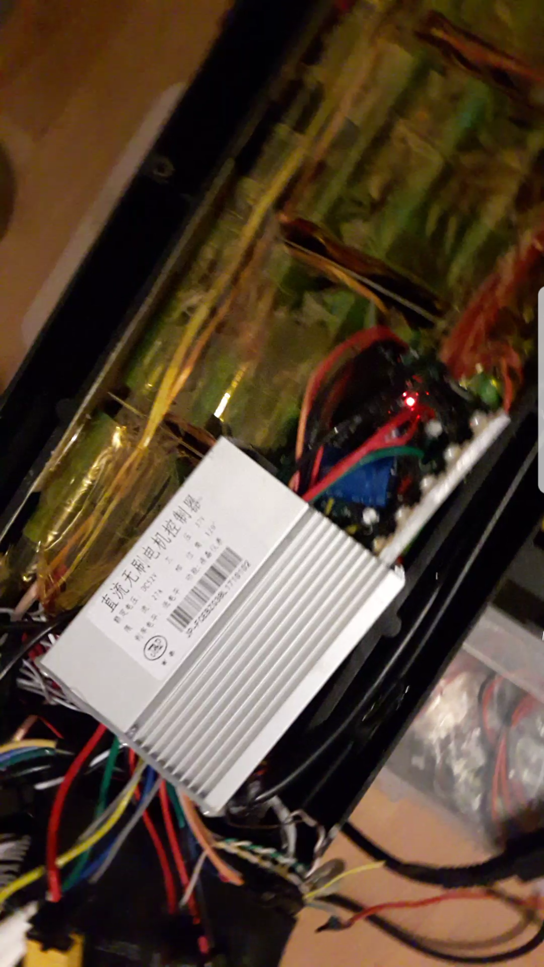

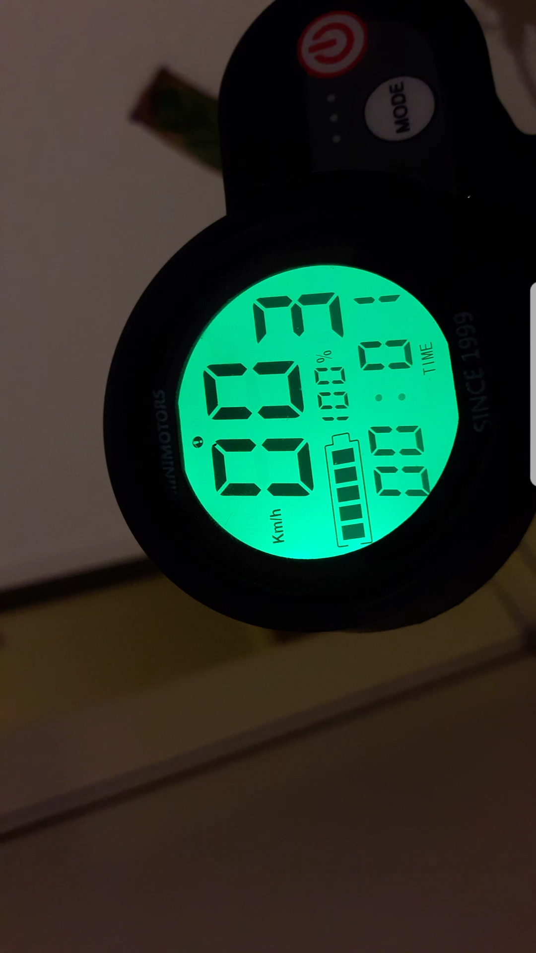

PatrickJay Posté(e) le 31 janvier 2018 Partager Posté(e) le 31 janvier 2018 (modifié) Hello from Germany. I need your help. I have read all 44 pages. I've built a custom scooter with Sw4 parts. The green LCD and the new controller with 27a (I ordered the version 30.5a, but got the 27a). My hub motor is the speed motor. But the scooter does not drive. The LCD shows no problems, but when I open the controller, every second a red LED flashes. Do you know the meaning? The engine does not matter if I accelerate or brake. I also checked the wiring. Modifié le 31 janvier 2018 par PatrickJay Grammar Citer Lien vers le commentaire Partager sur d’autres sites More sharing options...
joseantonio.noga Posté(e) le 31 janvier 2018 Partager Posté(e) le 31 janvier 2018 I think that screen is only mounted by Speedway mini and dualtron 2, it might not be compatible with the controller you are mounting, I suppose the battery will be 52v and the LCD also so it will not ...Enviado desde mi Mi MIX 2 mediante Tapatalk Citer Lien vers le commentaire Partager sur d’autres sites More sharing options...
En_Zion_La Posté(e) le 31 janvier 2018 Partager Posté(e) le 31 janvier 2018 The green display work for 60v set up (motor, controller and throttle). That's why Minimotors change the controller and throttle simultaneously. Your display indicated that your brake inns activated "!" So the motor is shut off. 1 Citer Lien vers le commentaire Partager sur d’autres sites More sharing options...
PatrickJay Posté(e) le 31 janvier 2018 Partager Posté(e) le 31 janvier 2018 (modifié) That's because I hold the brake when I shot this photo, sorry for that :-D. Are you sure that the LCD is for 60volts. I can choose 48,52 and 60v. My battery is 52v Modifié le 31 janvier 2018 par PatrickJay Citer Lien vers le commentaire Partager sur d’autres sites More sharing options...
sonkenn Posté(e) le 31 janvier 2018 Partager Posté(e) le 31 janvier 2018 @PatrickJay as @En_Zion_La said, it may be as simplest : your brake is on (brake lever, contactor, wiring...) so motor is shut off (feature of the controller) OK you answered... so maybe your P5 setting, assisted start (1) or direct start (0) ? assisted you need to make the wheel turn to activate the motor. 1 Citer Lien vers le commentaire Partager sur d’autres sites More sharing options...
PatrickJay Posté(e) le 31 janvier 2018 Partager Posté(e) le 31 janvier 2018 I did the default sw4 to the LCD. I also tried to edit P5 but no change. When I spin the wheel and put throttle nothing happens. But It shows me speed to the screen Citer Lien vers le commentaire Partager sur d’autres sites More sharing options...
En_Zion_La Posté(e) le 31 janvier 2018 Partager Posté(e) le 31 janvier 2018 The choice 48v, 52v or 60v on your LCD is not allow you to mount a 52v LCD instead of a 60v LCD. this parameter is used for calibrate battery bar on your display and calculate when your display blinks for "low battery" you lcd is powered so at least 2 wires are correctly connected to the controller maybe the 4 others are switched. 1 Citer Lien vers le commentaire Partager sur d’autres sites More sharing options...
PatrickJay Posté(e) le 31 janvier 2018 Partager Posté(e) le 31 janvier 2018 Now I see, kwheel send me the wrong LCD. They have changed the description, too. I will order a new blue 52v LCD. After that the scooter should work, I hope so... 1 Citer Lien vers le commentaire Partager sur d’autres sites More sharing options...
