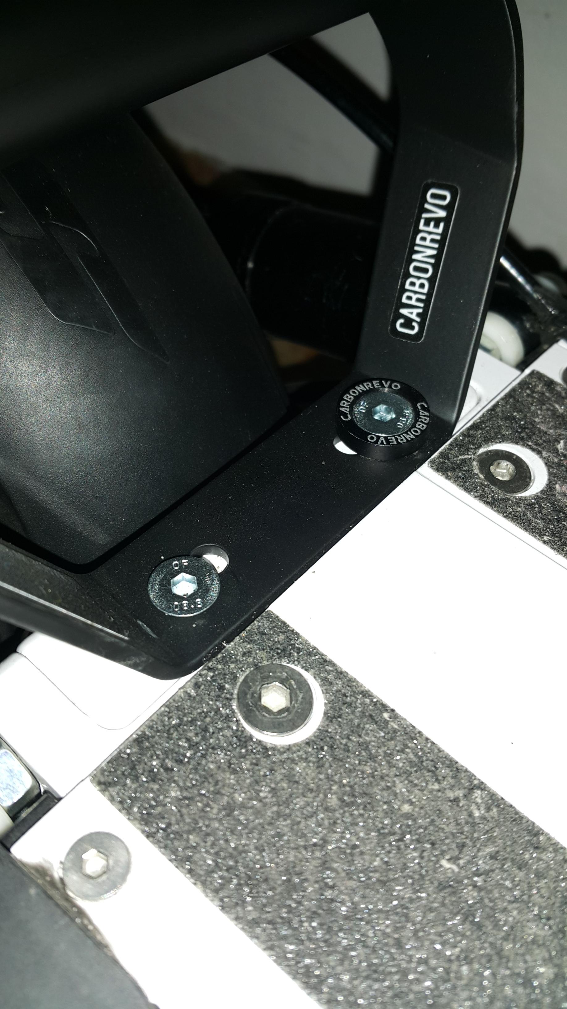

YaYaJaiJi Posté(e) le 18 août 2019 Partager Posté(e) le 18 août 2019 Il y a 4 heures, Damian Klos a dit : Hi everyone! Sorry for writing in English I just don’t know French - I love your FAQ - and google translator do the job I have question about rising suspension - yesterday I tried to do it but I couldn’t force shock absorber to fit to that second hole - are you using something to squeeze it first then screw bolt to suspension? Or I’m doing something wrong? I have also bought: https://fastride.fr/p/poignee-arriere-courbee-carbonrevo?fbclid=IwAR1JktEj8g3X7gd-a-mcIpIzpWRBTEI46W-6WanlbkHCa3p6xgqpd15OiTU from Carbonrevo - bolts they are supplying are too short you should buy yourself M6X20 to fit it to SW5 - but maybe in the future it will change - I have talked about it with them so there is a great possibility that they will supply it or give an option like with other parts. I also have bought these bolts: https://www.ebay.fr/itm/12-9-HIGH-TENSILE-SHOULDER-BOLTS-SOCKET-SCREWS-TOOL-POST-SCREWS-D8-6MM-THREAD/322989201754?ssPageName=STRK%3AMEBIDX%3AIT&var=512125660682&_trksid=p2060353.m2749.l2649 To remove steering play but it helped me only for one day - maybe just because I screw it stronger. Do you feel much difference? Or again I did something wrong Cheers! Sorry for my english, for rising suspension, i had the same problem, it takes a lot of force to compress the second shock, it's very difficult and you may need someone or a trick to help you. Same steering play with same screw, the problem is between the folding system part and the stem, there is a russian guy on youtube who make an upgrade with a piece of pipe to resolve it, but i don't found the link, if you get it please send it to us Can you describe and/or post photos for the carbonrevo handle pbm and how to resolve the problem ? Thanks ! 1 Citer Lien vers le commentaire Partager sur d’autres sites More sharing options...

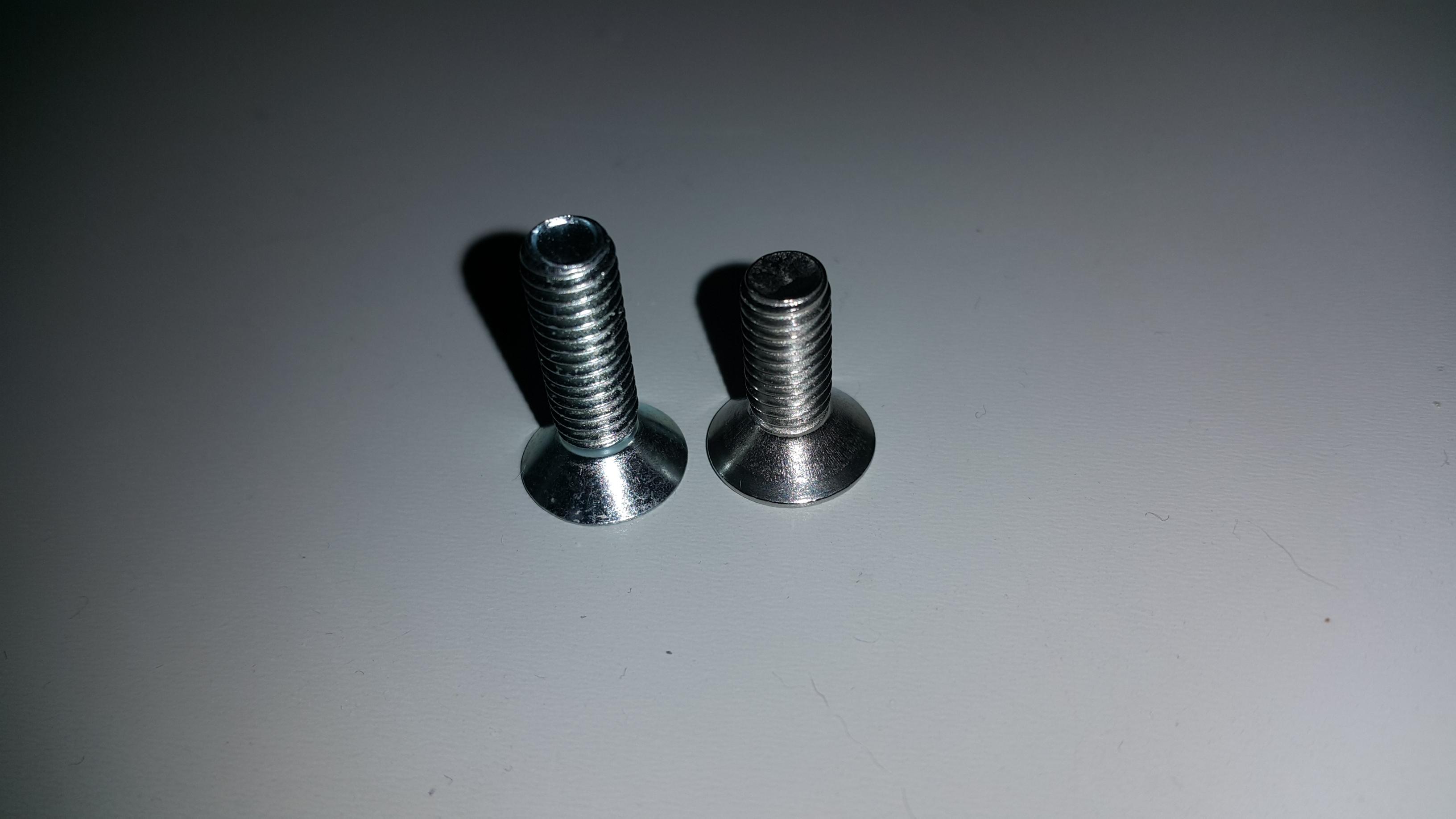

Damian Klos Posté(e) le 18 août 2019 Partager Posté(e) le 18 août 2019 (modifié) Thanks! I didn't want to use too much force but now I know I had to do it thanks again! About Carbonrevo Handle - solution is simple u need longer bolts M6X20 (there is a comparison on the left of the original bolt on the left one of Castorama). In my case there was also a small problem - one of the holes was so badly made that I had 2 x M6X30 and asked for my buddy who have tools to cut it - one will have 21 mm and second 22 mm - I hope that will solve problem - I should have them tomorrow. Right now I have screw it without a carbon pad and its fine (on photo). But I hope its temporary. Something like that - but I bought them in Castorama. https://www.aliexpress.com/item/32846959472.html?spm=a2g0o.productlist.0.0.126c3fdaQpiNPi&algo_pvid=07b346f3-ba3d-4c80-aac4-9ff81d33731c&algo_expid=07b346f3-ba3d-4c80-aac4-9ff81d33731c-9&btsid=a00b4919- ee84-40d6-8d61-134608c993ce & ws_ab_test = searchweb0_0, searchweb201602_4, searchweb201603_52 I will try to find that movie Cheers! Modifié le 18 août 2019 par Damian Klos Citer Lien vers le commentaire Partager sur d’autres sites More sharing options...
YaYaJaiJi Posté(e) le 18 août 2019 Partager Posté(e) le 18 août 2019 (modifié) Aw ! i didn't see the holes for the handle !! many thanks, now i understand how to fix it I recently orders many screws but no M6x20, i take it now ! I took this one: https://moburbaine.fr/index.php/produit/poignee-courbee-pour-speedway-4-et-5/ Modifié le 18 août 2019 par YaYaJaiJi Citer Lien vers le commentaire Partager sur d’autres sites More sharing options...
Damian Klos Posté(e) le 19 août 2019 Partager Posté(e) le 19 août 2019 aaaa its a little bit different than mine so maybe this one will have right one screws. You may try to ask seller about it. Anyway it should be easy to get that screws. Cheers! Citer Lien vers le commentaire Partager sur d’autres sites More sharing options...

jojocoollol Posté(e) le 1 septembre 2019 Partager Posté(e) le 1 septembre 2019 Le 18/08/2019 à 17:18, Damian Klos a dit : Thanks! I didn't want to use too much force but now I know I had to do it thanks again! About Carbonrevo Handle - solution is simple u need longer bolts M6X20 (there is a comparison on the left of the original bolt on the left one of Castorama). In my case there was also a small problem - one of the holes was so badly made that I had 2 x M6X30 and asked for my buddy who have tools to cut it - one will have 21 mm and second 22 mm - I hope that will solve problem - I should have them tomorrow. Right now I have screw it without a carbon pad and its fine (on photo). But I hope its temporary. Something like that - but I bought them in Castorama. https://www.aliexpress.com/item/32846959472.html?spm=a2g0o.productlist.0.0.126c3fdaQpiNPi&algo_pvid=07b346f3-ba3d-4c80-aac4-9ff81d33731c&algo_expid=07b346f3-ba3d-4c80-aac4-9ff81d33731c-9&btsid=a00b4919- ee84-40d6-8d61-134608c993ce & ws_ab_test = searchweb0_0, searchweb201602_4, searchweb201603_52 I will try to find that movie Cheers! Bonjour, Tout d'abord, bravo pour ce FAQ, très utile pour les débutants comme moi, mais, jaurai une question au sujet de la poignée, il faut forer les trous pour les vis ? Je ne comprends pas comment la fixer correctement, je n'ai pas de trou prévu a cette endroit ! Quelqu'un pourrait m'éclairer sur ce point? Merci Citer Lien vers le commentaire Partager sur d’autres sites More sharing options...
Raf Posté(e) le 1 septembre 2019 Auteur Partager Posté(e) le 1 septembre 2019 (modifié) il y a 17 minutes, jojocoollol a dit : Bonjour, Tout d'abord, bravo pour ce FAQ, très utile pour les débutants comme moi, mais, jaurai une question au sujet de la poignée, il faut forer les trous pour les vis ? Je ne comprends pas comment la fixer correctement, je n'ai pas de trou prévu a cette endroit ! Quelqu'un pourrait m'éclairer sur ce point? Merci Salut, Merci, c'est un travail collégial des membres telegram ? Normalement tu as deux trous à cet endroit prévus pour mettre une selle à la base. Ta poignée doit se fixer dans ces 2 trous ! Modifié le 1 septembre 2019 par Raf Citer Lien vers le commentaire Partager sur d’autres sites More sharing options...
jojocoollol Posté(e) le 1 septembre 2019 Partager Posté(e) le 1 septembre 2019 il y a 28 minutes, Raf a dit : Salut, Merci, c'est un travail collégial des membres telegram ? Normalement tu as deux trous à cet endroit prévus pour mettre une selle à la base. Ta poignée doit se fixer dans ces 2 trous ! Ho purée oui je viens de voir les 2 trous ? Citer Lien vers le commentaire Partager sur d’autres sites More sharing options...
